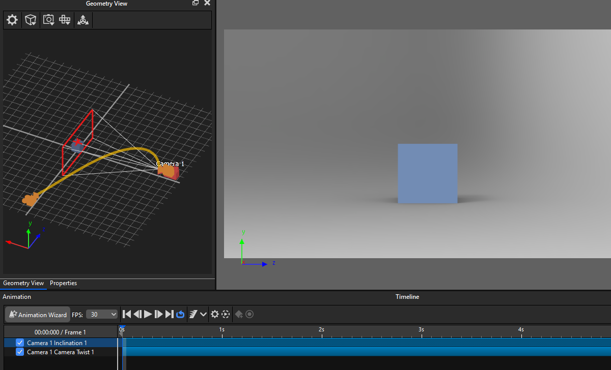

I’m facing an issue in translating the camera motion from Keyshot to After Effect.

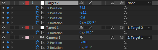

I have to add graphic elements to the animation in post, so I’m recreating the camera motion inside AE by parenting the camera to different targets around an OBJ from KS.
Twist animation works really weirdly in KS and rotate the camera along its Z axis doesn’t fit the KS image as it should. I know issue is from twist, I remove and export still at same frame and OBJ perfectly fit the KS frame.
Anyone as an idea on how to integrate the twisting camera animation inside AE?

That’s not an import issue, as KS doesn’t export camera motion information. That’s why I have to recreate the camera motion from scratch, in pixel dimension, inside after effect. At least if someone has another faster solution, I’m open.
As AE camera doesn’t use same motion solver as KS, I have to understand and translate KS camera to AE camera.
I’m use to do that but first time with a twist animation, and twist motion hierachy is hard to translate.
It’s like incline motion modify the twist axis, or twist axis doesn’t follow the camera axis if incline animation is applied.
both animations are 90°
